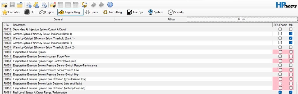

I finally got the P0456, surprised it took this long. So I did what any sane person would do. disable all that junk ;)
Love when it cost nothing to fix a problem .. lol... I also completely removed all the other codes that fall under evap system :dogpile:
