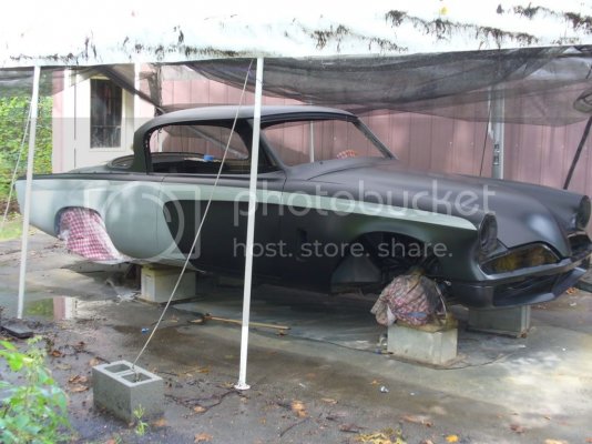

The problem you will have with anything other than a quality booth is dust and bugs. Particularly bugs. When I painted the 54 Stude I used an inexpensive screened in canopy from the local big box store.
A few days before I started painting, I hung several fly strips in the enclosure and stayed out. You'll be surprised at the number of bugs you will collect over that time. Then waited for a calm day, moistened the pavement under the car and shot it.
Had a small number of dust particles but you can't sand spots out of the Blitz Black and the car looks darn good.

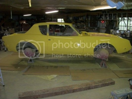

When I did the Avanti last year, I did it inside the pole barn. Before I painted. I put a screen over the large and small door, hung plastic sheet on the ceiling over the car and covered the floor with plastic sheet and fresh cardboard from large appliances. Again hung fly paper all over the place and stayed out for a week.
Put my 30" fan to blow out the large door and shot the Avanti, the windows in the barn are already screened.
Again a pretty nice paint job considering no booth.
Remember to use the best mask and gun you can afford.
