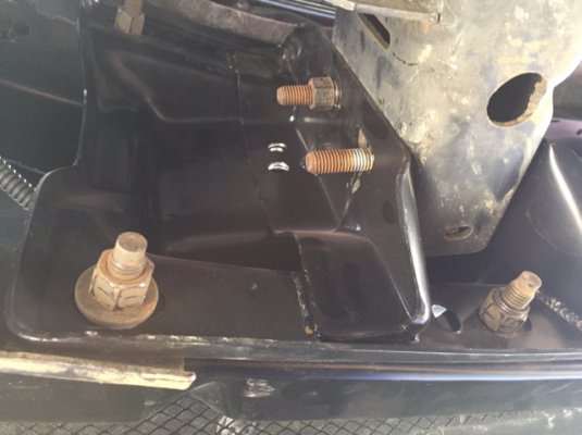

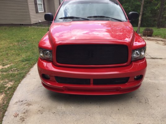

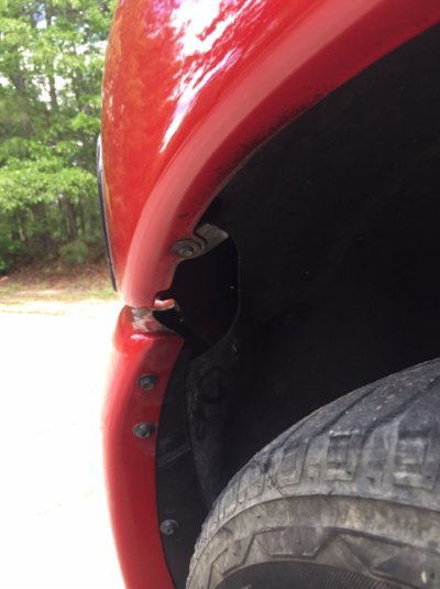

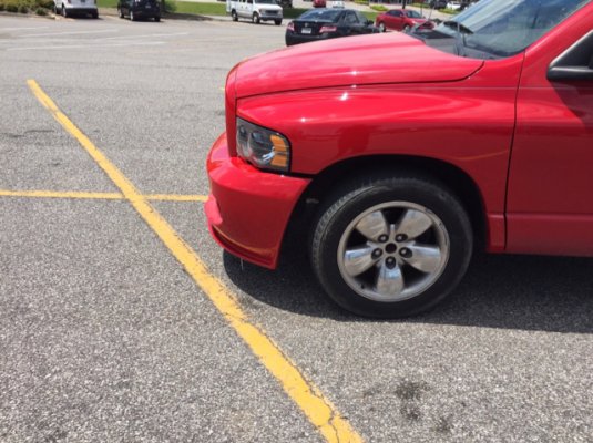

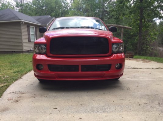

Here are some pictures of it I took the day of getting it back from the shop. I am partly at fault for buying a cheaply made Srt10 front cover, I was told it was a good cover and then upon arrival found out that it was going to need a decent amount of work to be in good condition. This I also took into consideration when I purchased it because I have worked with fiberglass parts in the past and they don't have a very good reputation for being spot on. I am currently at work at the moment and I will take some more pictures tomorrow of some of the cut up work that was did. Also as you can see the fog lights don't line up either. In the last picture you can see where some nuts and washers were also left off and see that there are 2 randomly drilled holes in the steel bumper. Overall I'm just not happy with the way it turned out and I am looking into changing it. I let it go for a while to see if my mind would change on it but it hasn't, it might would if I were to slot the holes on things and re-line it but I don't want to go throw th all that trouble.

i feel like there is plenty of room for adjustment, even though you say you dont want to go that route, the two holes drilled in the bumper mount pictured, not sure what they are for, nothing he did really justifies those holes, also your bumper mount in the same picture is missing the lower bolt and frankly all but one of the bolts in that picture are the wrong bolts for your bumper, so something else is fishy on that install, the missing nuts and incorrect nuts throw up a red flag for me and would have me looking all over that bumper for things out of wack, the cover actually looks nice in the pix, just needs a good adjusting to be correct.
Edit: looking at those pictures it appears the truck has been wrecked, are you the orig owner? that would explain alot about the wrong/ missing bolts and poor fitment

I see one immediate problem that could be fixed in 10 minutes. They have the front of the bumper shoved too far up in the front. There should be some space under the grill and headlights. Up too high in the front will cause alignment problems on the sides. I figured that out the hard way with my truck. I wanted to close those factory gaps down, but it looked even worse.

I see one immediate problem the could be fixed in 10 minutes. They have the front bumper shoved too far up in the front. There should be some space under the grill and headlights. Up too high in the front will cause alignment problems on the sides. I figured that out the hard way with my truck. I wanted to close those factory gaps down, but it looked even worse.
shop did that to my dads truck aftger they fixed his front bumper, made it damn near impossible to remove the headlights, the gap sucks but has to be there
