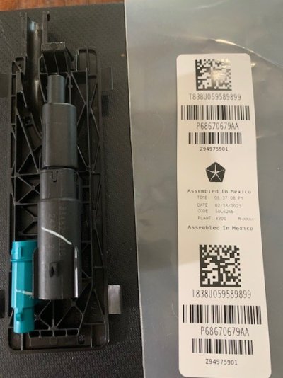

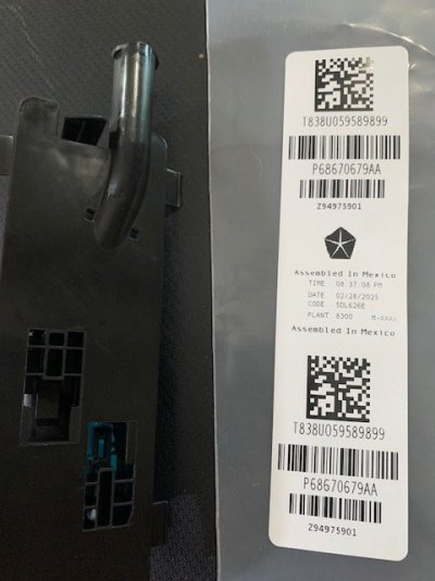

I just bought a 2025 heavy duty tradesman and found this part under the back seat when I got home. looked up the numbers but came up empty. any help in ID these would be great.

possible cover for when you remove the rear tailgate ref wiring harness? You have the extra rear camera accessory? Only guesses I got.

That is for the tailgate where the harness plugs in for the rear camera and tailgate. It’s located just below the bottom of the tailgate. That piece acts as a plug when the camera/harness is disconnected and tailgate removed. Basically as I understand it completes the circuit as if the tailgate was still there so you don’t get the tailgate open light and error message for the rear camera being unplugged. Don’t lose it!
