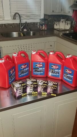

I am looking at Amazon right now for redline. Do you use the 5w20 in the red 1 gallon jug? When I click on it it asks what vehicle I have, when I enter my vehicle info it says not for your vehicle? As for the royal purple filter what is the part number for a 2012 ram bighorn 5.7?
R.L.K.
Dec 1, 2013
12,803
12,508
Bristol , Tn.
5W-20 or the Prefered 5w-30 Redline oil.
And the RP 10-48 or the larger RP 20-820 Filter .
Here are pics of the Gal. & qts .
