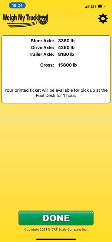

Agreed. My step-son has a 2020 Tundra with a max tow of 9800lbs. His new 2021 Grand Design Imagine 3250BH weighed 9300lbs on the CAT scales with 1100lbs tongue weight. I towed it home from the dealership with my 2500 but he towed it to his campground with his truck. He weighed it too. He was under his max tow by 500lbs he was over his GRAWR by 160lbs
