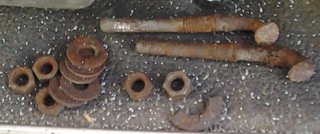

still sandblasting everything and and hitting it with penitrating oil and it seems to still work good. here is a picture of the last bolts i sandblasted and hit with penitrating oil. believe it or not these where holding my gas tank up and nuts came off very easily.
