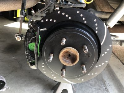

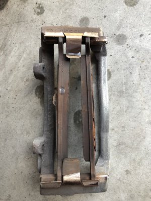

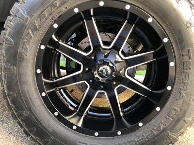

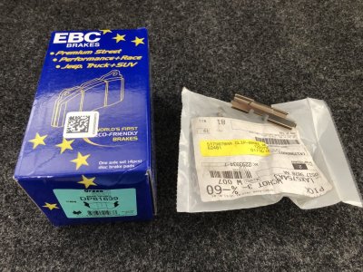

Matt (@Hemi450hp) at Moe's Performance was really helpful as I knew I was up for some brake pads and rotors. I went EBC for front and rear (green stuff pads) and I decided on the "green stuff" 6000 and 7000 series pads as well as EBC slotted rotors. I opted for gloss black on the calipers and I am very pleased with the results. Here is the work up for the rears I did today, and I will do the fronts this weekend.
I also got new Mopar caliper clips (white bag).

Love everything except the green paint on the pad. I realize the green is part of the product and would probably source a different brand. Rotors look great! I want red calipers!
Thanks!
I know, I was a little bummed on the green too, but it is really hard to see unless you're on top of it. The grass in the pic kinda throws it off.

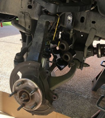

Progress on the fronts. Holy Hades, it is friggin HOT in Central Texas.

This job is done! Fronts were much worse shape than the rears. Torque caliper bracket adaptor bolts to 130, and caliper mounting pins to 24. It is officially beer:30.
Sad thing is I gotta go back and replace a slightly worn out and torn piston bellow. That sucks. So, I may as well replace all of them...
