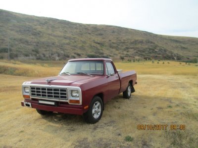

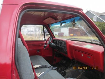

Here is a couple of pics

Thanks again everybody. I hope to make a decision in the next few days. Then it will be making a parts list, saving up the money, and storing parts as I gather them.

My son decided to sell the truck. Any thoughts on a fair price given the blown motor?
Thanks again.

hard to say without seeing it in person but the bad engine definitely hurts the value quite a bit. if the body is as clean as it looks you might be able to get $2000 for it.

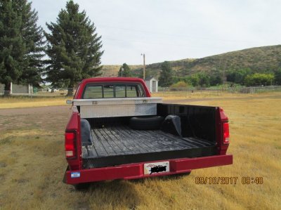

Here is a couple more pics.
Brand new Discoverer AT3's on all four corners. There might be 800 miles on them.
