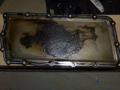

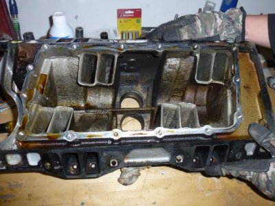

Here are couple of things we found helpful and may not apply to all plenum replacements.
To protect the lifter galley, we cut up a contractor grade garbage back and tucked it in and up under the block casting. Then we cut a card board pattern and fit it in over the plastic. We literally go zero contaminants in this area. You can see it in the pics.
If you are pulling the water pump during this repair, use a wet vac to suck out coolant from the area's that could pollute the lifter galley. We went in through the water pump holes and sucked the coolant down before we pull the manifold. Again, we got zero contaminants in lifter galley.
We did not find it necessary to remove the cap and wires to do this work. We had already replaced them prior, though we did do the wire routing suggested in the TSB.
