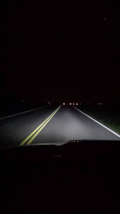

It is kind of scattered, but i havent been flashed yet. They arent scattered as much as HIDs

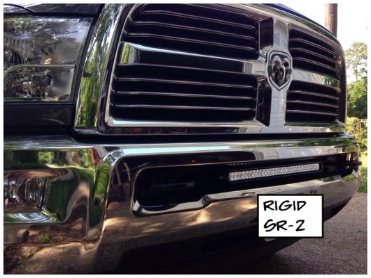

Get a LED bar and mount it between your tow hooks. You won't outrun this light output.
Yeah, I've thought about going this route as well. Price difference is negligible. Might buy whatever this weekend
If you are worried about outrunning your lights this is definitely the way to go. My night pic actually doesn't do it justice.

Pics do no justice. High beams are useless, fogs seem mainly for looks.
The 2 looking at the truck are about 30ft out. One of them is in the oncoming lane.
