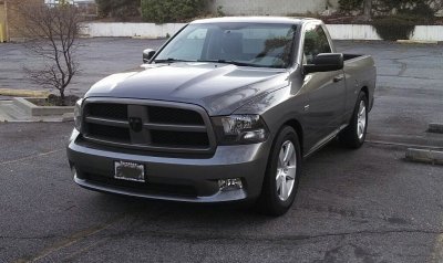

I have the stock 17in rims and tires. I like them but think they would be nicer black. Will the tires have to be dismounted so the rims can be powder coated black?

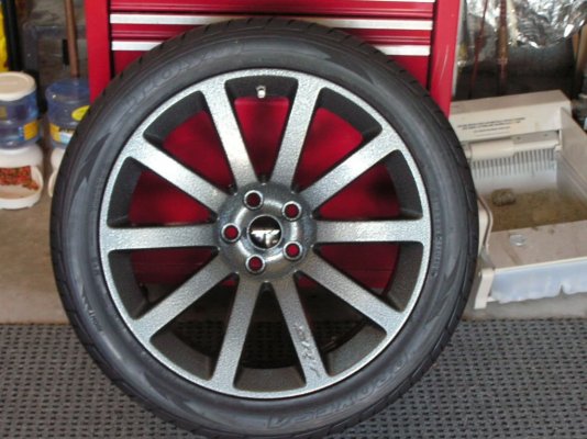

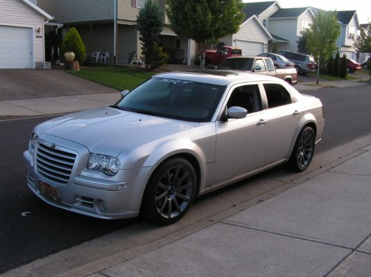

hmmm....well, my current setup on the SRT8 looks like this, a Cardinal "Silvervein" powdercoat on the face and spokes, matte black on the backside and inside barrel, then a 2mil clearcoat all the way around:
I didn't want black because I didn't want the wheels to disappear nor did I like the stock finish which looked like this:
It took a week to get them done but was busy tearing the car apart anyway so no rush:
In any event, I kinda liked the results and I did the powdercoating back in 2008. The finish is still good, no peeling and no issues at all.
That's pretty sweet, so is it like a hammered look/feel?
Exactly. The 2 mil clearcoat smoothed it out some but it still has a profile you can feel.

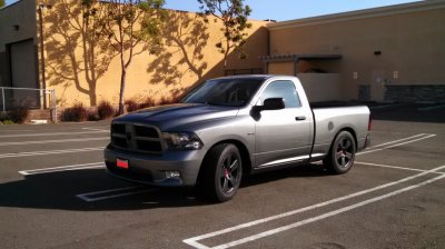

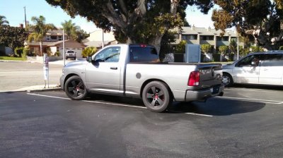

Here are my stockers, powder coated textured flat black. It's been about a year and they look like the day they were done. Plus, I don't even need to clean them... just spray them off at the car wash. I have wiped them down maybe 3-4 times in the last year.
