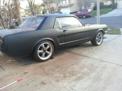

I'm plastdipping my entire 66

Three cans fir what see there
