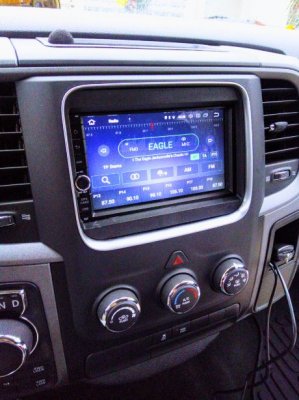

A quick up date on progress. Remaining harness was wired and tested. Everything working as it should. I need to complete the install tomorrow, then move on to the front speaker upgrade (rear done). From very brief run through of the Android head unit I am loving it.
Completing the install got bogged down in dealing with the bezel facia. The radio is slightly larger (2mm) thank a standard 2Din and has a volume knob on the drivers side. I was able to use a Dremel and a sanding cylinder and give the knob enough room to move freely. There is a USB/SD card cover that is impacted by the bezel - need to think of a way that can give me a few mm to open close the cover. Probably more Demel work tomorrow.
Installed the support rails for a test run and the machine screws project from the side and will not allow the radio to slide into the dash. Off the the hardware store tomorrow to find something that has a flat head.
Other than those issues, real close to finishing up. I'll provide a write up/lessons learned and post a few pics. My gratitude for all that contributed and helped me get this far. Cars were simpler last time I did this!

So the head unit is in and I am really satisfied. It was rainy all day so I could not install the new speakers, but just changing out the head unit is like a whole audio replacement. My only complaints about the unit is the download speed off wifi is very, very slow, the rear view camera is blank (may have connected the wrong cable) and I cannot get Spotify to load. Below is the gear I used to get this working on a 2017 Tradesman Crew with UConnect 3.0, no amplifier:

Major issues faced in installation was the incorrect harness matching on the Metra website. I initially purchased the AX-ADXSVI-CH3 harness, tested the radio, and had no ACC power. When the radio tested good, I purchased another harness thinking the first was defective. Again, no ACC power. After calling Metra, the correct harness was purchased and worked. This caused several months delay and frustration, partly because of the incorrect harnesses, but also not understanding that the factory harness does not deliver ACC power to the head unit. The only way to accomplish this is with the correct harness and the interface which mimics ACC power to the unit via the interface and the 12V+ ground. If it wasn't for this forum and support, I probably would have paid someone to install the unit.
Minor issues were a few. (1) The radio is labeled a 2DIN radio but exceeds the global 2DIN size by 2mm horizontally. This causes the mounting frame to flex around the radio when the rails are added. The fiber washers helped press the rails to the sides. And without the flat head machine screws, the radio would not clear the dash frame. (2) The radio has a volume knob and a SD card slot covered by a tabbed cap. The dremel was used to clear a space for the knob to move freely and access to the SD card slot.
The radio came with a GPS antenna, mic, and double USB dongle. I used Velcro applied to a space directly under the dash and the GPS antenna to secure it there. I have excellent GPS satellite reception. For the mic I drilled a hole in the cubby on top of the dash and installed the mic. I have not tested it. The USB cable was routed thru a hole drilled in the dash right panel cubby. Note: you loose the USB connectivity in the center console. You can connect a micro-USB tail or a USB/Apple tail to the USB cables and charge phones.
Connecting the LC-CHRC-01 harness to the radio harness was not difficult but took matching each wire by function (not by color). The Chinese harness manufactures seem to throw whatever colored wire on hand into the pins and they rarely match a standard function/color scheme. You have to pay attention to the radio wire diagram. I added the inline fuses to the ACC and antenna power lines replacing the fuses that can wired with the harness (snap/twist, easier to replace if needed).
So far I have tested the GPS with Google Maps (excellent) and equalizer (really impressed). Adding a 1TB SD card allows Android 8 to see this as internal storage, providing more than enough room to add maps and music files. Overall, I think for the $ outlayed I have exactly what I envisioned planning to upgrade the UConnect 3.0.
