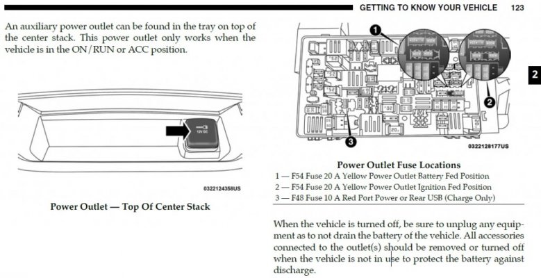

Two power questions:
1. Can the 12 volt (old cigarette lighter style) be set to turn on and off when the vehicle is started, and turned off, I want to keep my dash cam plugged all the time.

1. Yes. I'm not sure what year your truck is but this is from my 2019 Owner's Manual:
