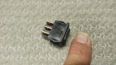

Who were you able to find that can add the LER sales code to an Express? OBD Genie is currently working on a genie tool to add the code then unless something drastic has changed dealers are not able to add this code to the Express or Tradesman. I wired mine to two mini switches just like you described a long time ago they work great. I did a write-up on it in the 4th gen DIY section. I mounted the two mini switches in my door panel that control each mirror separately if I chose too.

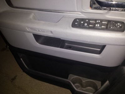

Mike Toler dealership service department told me they can add the code to my truck if they install the modules and the switch. I'm going the route of switches. Thinking of putting mine in the no frills overhead panel I have . How did you cut your plastic? Xacto knife is what I'm planning on using but want it to be very clean and look OEM...sorry to thread jack.

In most cases the dealers are not aware they cannot add the code until the try. It will not be on your options list. The only way to add it the code is to contact W.I.C (Warranty Information Center) and see if they will add it to your Vin which is nearly impossible to do. I have seen several people buy all of the components thinking they can add the code only to find the dealer actually cannot. Hopefully OBD Genie will come up with the tool to add the code for those who want to install the factory setup. As far as cutting the holes I used an exacto knife and a drimmel tool. Honestly the hardest part is routing the wires through the drivers side door harness with the parking brake in the way. Since your truck seems to be pretty basic you may have more room for wiring than I did. The wires you want to tap into on the mirror are the light blue wire and the yellow wire in the black mirror plug. I just wired a six pole mini swith for reverse polarity just like you were considering and they work great. They have been installed in my truck for over a year and I use them every time I drive the truck. I also installed Big Horn door panels so you will need to figure out where the switches work best for you with your door panels.

Man that stinks about the dealers being so clueless on what they can and can't do[emoji849]. And no drama at all, I'm all about getting the right information. Those big horn door panels look great and the switches blend in perfectly. Whenever my mirrors and switches show up I'll throw some pics up where I end up mounting them.
