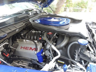

I dont even think twice, I keep my engine bay clean just like the outside, wash all my vehicles motors.
everything has sealed connectors, ever follow a semi in a rain storm.? lol

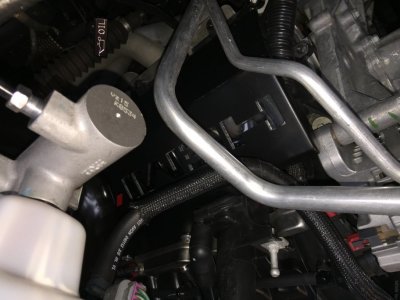

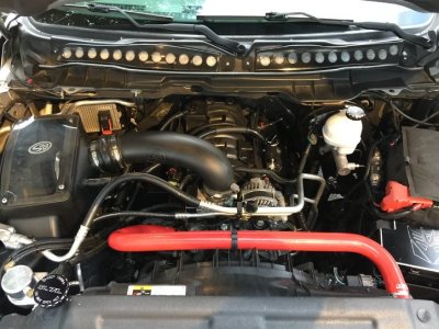

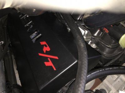

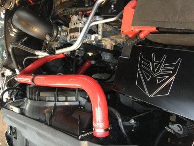

This is how I do mine every 3-4 months you could eat off mine.

Those are some really purdy motors guys, thanks for all the replies. I'll probably try it this weekend. I seen a mix of vehicles running vs. vehicles not running. I just assumed a cold motor would be better but a warm motor would dry faster? Just a thought.
