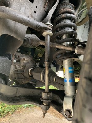

I did all of the work myself, so I am to blame on this one. Wife already said I told you so. I'm hoping that this picture is the preload spacer you speak of, because I did leave those out due to the bilsteins.

Lift the front by the crossmember and get the wheels in the air and rotate them by hand, see if you can hear/spot any issues with the hub bearings, calipers dragging etc. Any issues wiggling the wheels by your 12-6 o'clock, how about 3-9 oclock ? pay attention if the BJ's in the UCAS or LCA's are tight. If you have any type of movement on the wheels you either have a bad bearing or facked up BJ's.
If everything checks ok, then check the DS. Did you completely disconnect the drivesahft and re-install it correctly ? how about the DS spacer ? check the DS spacer is not rubbing against anything ? sounds silly but go back and recheck everything you did, look everywhere if it's rubbing something has to have a mark somewhere indicating so.
