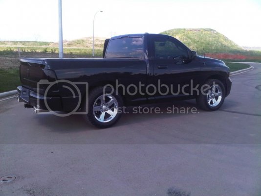

The only thing any truck needs to get away from the 1000rpm - 2800rpm "bog" off the line ...:Sumo:
..is higher stall Torque Converter that totally bypasses that rpm range :slap:
Absolutely No tuning required! 100% Plug&Play
My Edge 2800 can light em up at will with less than half throttle
...and that's with 3.55 gears on my heavy 4x4 with 90lbs of 305/50R20 Terra Grappler per corner.

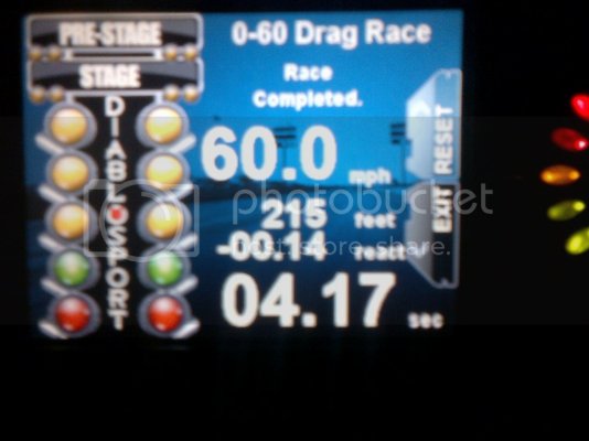

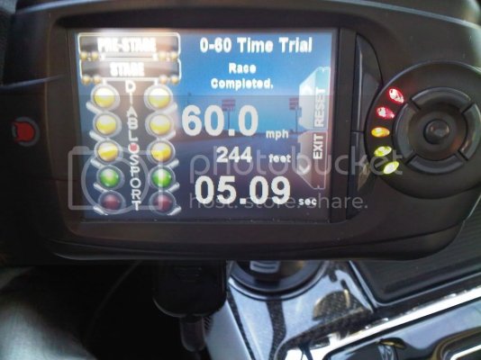

When I full throttle launch my TC flashes to 3000rpm instantly and I'm well into the powerband in no time
60' times at the track dropped from 2.2's and 2.3's to 1.8's
0-60 on Street Tires...
Now that I have supercharger I have to keep it in 4-Auto (AWD) all the time (or it will just sit and smoke the tires off)
and my TC now hits 3300rpm at launch with the Boost pushing the stall speed up an extra 300 rpm.
