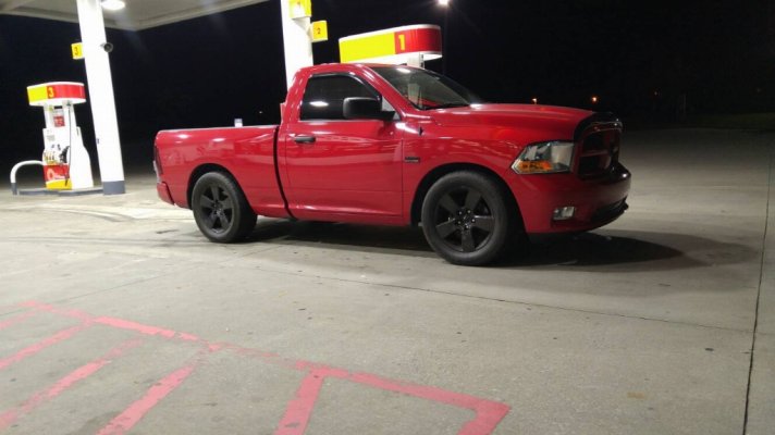

Spent another evening at the track testing different tire pressures and launch rpm. Finally made it out of the 14s. Then ended up running even better..... 13.876 against a 2010 camaro ss who ran a 14.004 ( he missed a shift but I don't care, I beat him )

Spent another evening at the track testing different tire pressures and launch rpm. Finally made it out of the 14s. Then ended up running even better..... 13.876 against a 2010 camaro ss who ran a 14.004 ( he missed a shift but I don't care, I beat him ������)
Hahaha nice!! Good win! Also, nice looking truck. Diggin the color... ;)

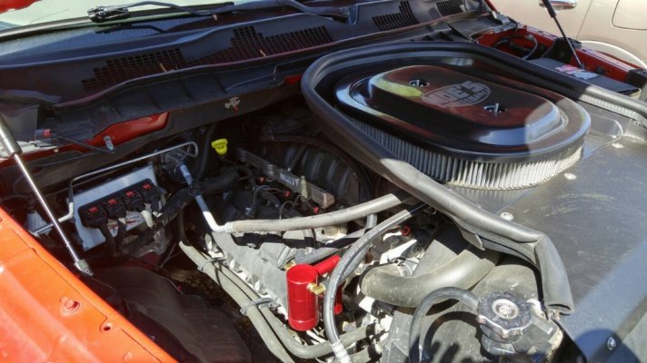

Installed catch can during lunch and removed clutch fan. I want to see how the factory efan does, I ordered a Dorman from Advance ($140) but it'll take a couple days to come in. I was going with the Amazon 1 but I kept reading about complaints so I just went with Dorman.407b6cb6dcf02a0eadf76dd68473c724.jpg

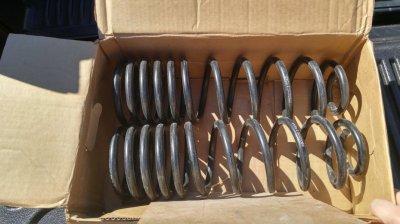

So I finally lowered it. Belltech 2-4. Also installed JBA long tube and y pipe. Still factory exhaust. I'm still going for the quiet sleeper. Underdrive is waiting too be installed also.
Sean (Hemifever) updated my tune. Truck is running strong, faster than it ever ran in cold weather. So I can't wait for this fall to see what kinda times it'll put down.
