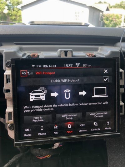

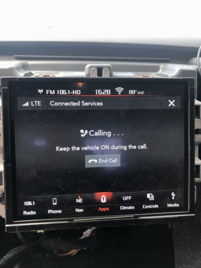

Have an update got the 2 pcs in to make the antenna. All you have to do is connect the two together and plug it into your radio. I just set my antenna behind the radio and it’s getting decent reception. The area I live in is a slight dead zone at least for my phone but this antenna picks up the signal very well. I call Uconnect with the assist button on the mirror and talked to someone briefly just to make sure it worked. Lol. The link below is what I ordered off of eBay. Took about 15 days to arrive but working good so far
Few pictures with proof of good signal even LTE
Below link is what I ordered on eBay
https://www.ebay.com/itm/Car-Telema...tail-6-quot-/173907959230?txnId=2017137898007
https://www.ebay.com/itm/4G-LTE-GSM...gnal-Booster-/382924673276?txnId=982830333025
One side of the antenna has double sided sticky tape and the wire is about 9ft(3 meters) so you could run it about anywhere
—2018 Ram 1500—
—2018 Ram 1500—
Interesting. That antenna looks pretty much just like the one I got, except the one I got had the Fakra-D connector on it directly and was listed as a 3G antenna. The other difference is that I have an RA4 radio as opposed to the UAx type that you appear have. I'm pretty certain that the RA3/4 is a 2G or 3G connection unlike the 4G connection on the UAS/Q radios. I might give it another shot with the one you got and see if it works any better. If I do, I'll post the results.
-K
Yeah I do have a UAQ lol. Worth a try. Now I have free WiFi for the time being lol
