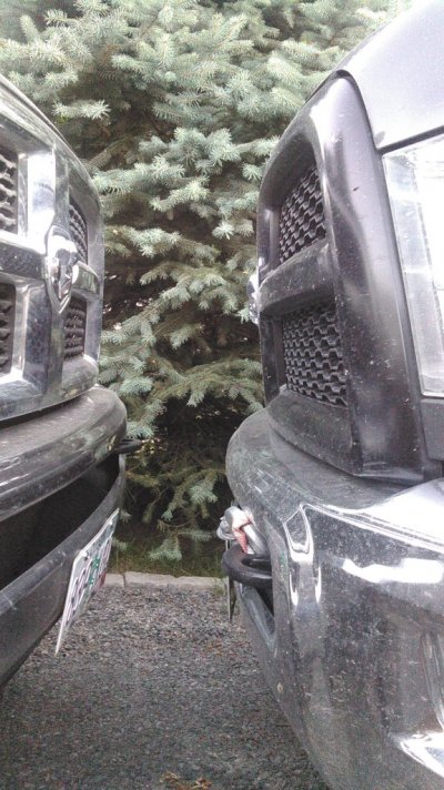

This bumper to bumper photo was taken a few years ago. On the left is a 2014 Ram 2500 Laramie Cummins on 35's (285 75R18) tires with a leveling kit and on the right is my 2016 Ram 2500 Tradesman Power Wagon on the stock 33's. Mine was not as high up and that's what I was checking. I run 35 12.50R17 tires now, so maybe they are the same height now. Both of these stock bumpers look similar.
