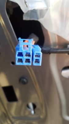

So the other day I noticed that my passenger rear window will not go down. I pulled the panel today and bench tested the motor.
It works In both directions. Also tested the switch, and replaced it. Window will go up via the switch, but not down. The driver door switch, and rear door switch are the same result. Up only.
So I started probing wires.
What I notice is that the bottom right wire in this picture is NOT grounded.
On the driver side (which I pulled the switch to compare) it IS grounded.
I don't know if this wire is broken somewhere between the front and the back?
My initial thoughts were to splice a wire into this one, and ground it to the door shell, but I don't know if that will hold a circuit open elsewhere and drain the battery?
If I ground that wire with a probe, the window operates in both directions as it should.
Anyone else run into this?
Does the driver side door switch somehow also supply the ground...and possibly need replaced?
Thanks all.
