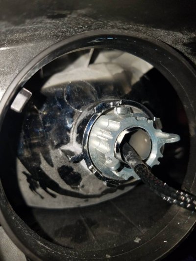

Nice, it came recommended from the Company i plan to get the parts through. I'll have to see what funds allow. If you do go that way keep me in the loop. Would like to hear your experience with mounting it all in the housing.

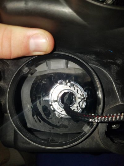

Got the Hi-Lens. No issues mounting the Hi-Lens into the high beam reflector.
I removed the black plastic ring for the 9006 bulb and used the 2nd smallest washer behind the nut for the Hi-Lens. No clearance issues or.mods made.a74625d607872f24268c4ca00f386754.jpg1137171c70aed2329d89b123e8b02f32.jpg808aaab42c50532e9aef0d89df7af595.jpge148c371bf5872c132738e8d30f7a45b.jpg

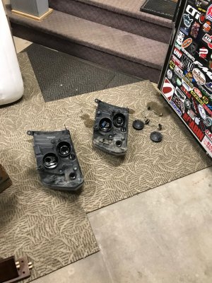

First step was swapping in the used set of lamps I bought locally. These are absolute garbage. The lens' are so scratched and fogged up that these will probably just go in the trash when I'm done. Most of the clips were busted or cracked. I should have checked them over better...
Whatever. My original ones are in much better shape.

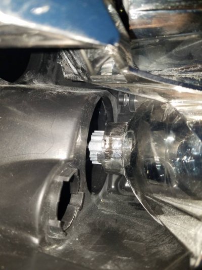

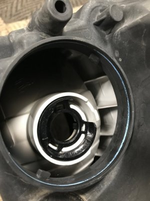

Had a small issue when swapping over my bulbs. Turns out the used set I bought didn't have the black clip to hold in the high beam bulb.
So of coarse I broke it trying to get it out and snapped a piece off the housing.
Need to order the black piece so I'm not driving around with no high beams. I'll try and JB Weld the housing piece back in but its small enough that the Profile lights i have coming should still mount with no issue.

and just got off the phone with the parts guy at the local dealer. Seems the black clip i broke is only available with the head lamp assembly.
I'll need to do some more digging.

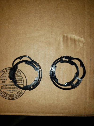

I have the black clips for the high beams if you want them....they're off a set of 2014 head lights.

How did you get them off?
Pretty sure I don’t need these to mount my new lights so I could use the one I haven’t broke.
If I can’t get something to work I may take you up on your offer.
OC455
Apr 20, 2018
3,326
3,017
Central NY
2018, 2019
The ones that I have, I squeezed them to get a locking tab to clear and then twisted them and they pulled off. I'll get a picture of them to see if they are different.
ok. And mine seem to work that way too. They seem like they need to be pushed out after the lights are baked and separated.

The ones off the back of the 2014 lights621d59d0797b5d6be214b83a437228b5.jpg

Pretty sure those are them.
How on earth did you get those out of there? Don't really have a need to worry about the high beam bulb for now.
