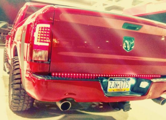

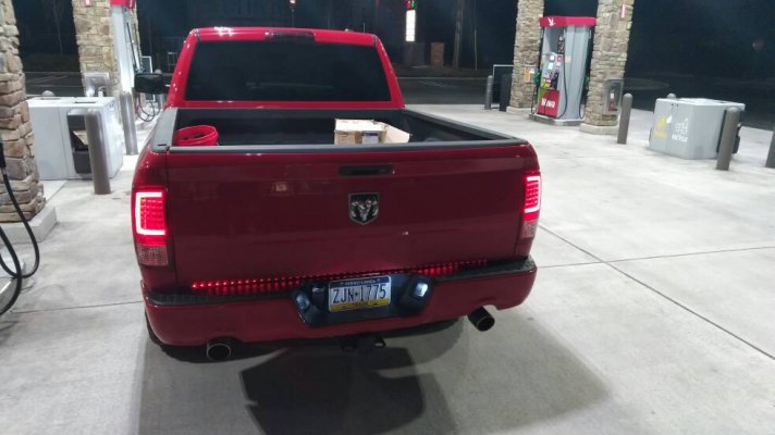

I've got the Opt-7 60led tailgate bar and it's been on 2 Rams now. Went through 2 harsh northeast winters and even when I got rear ended it was undamaged. I swear by the Opt-7 led tailgate bars. Either I got a super rare invincible one or they are all rock solid and extremely well made.

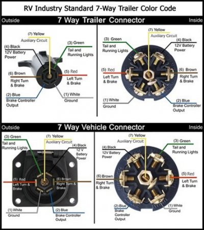

I think the reason they instruct us to run that back up light wire to the bulb in the tail light is because we don’t have a backup light circuit in the pigtail plug.... There’s a 12-volt circuit that comes off the battery to run accessories on s trailer but I don’t think there’s on for backup lights. 2e8dfc681d11c73cafaf6ed084bebf56.jpg

Hmm, white is supposed to be ground.

I don’t know, since there’s so many different configurations for 7-prong trailer plugs out there, maybe we do have a reverse light circuit, I have no idea. I’m not near either one of my two pickups to go look but I would say that if we do have a backup circuit in our plugs, use it. Who knows - when I put that Anzo light bar on my old truck long time ago, I probably didn’t even have to pull the taillight out and tap into the wire up there but I definitely most certainly will be checking into that this weekend when I go to install my new lightbar on my new truck.

You are correct. I was thinking the Wire is the White wire on the Bar.
