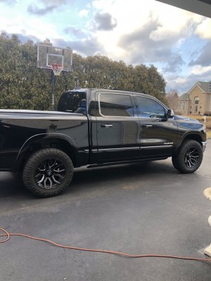

I have new limited with air ride. You can get kit that fools computer to leave at set height no matter what speed. I have 35’s NOT TRIMMING OR RUBBING at ALL
Beautiful Truck!!! What is that kit? Did it cancel any warranty stuff? what kind of MPG you getting with those 35's and locked higher ride? Thanks,
