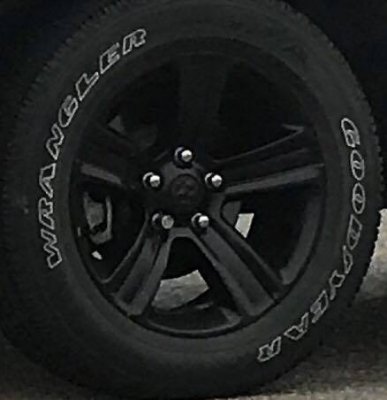

I'm swapping to from the silver steel rims to the black aluminum ones.
Will the lug nuts from the silver ones be the right ones, or do the aluminum rims use another kind?
If I need to order new ones, a part number or link would be great.
Thanks!

If you like, follow this link to the parts department:
https://parts.allmoparparts.com/aut...8-gas-engine/front-suspension-cat/wheels-scat
Here you will find your steel wheels as item #1 I believe. The related lug nut for that wheel is (I think?) shown as 6509422AA .
I have the same black alloy wheels on my 2018 Sport 4x4. If I've searched correctly (think I did) then these are the same lug nuts I have in use.

if they aren't the same and you want oem lug nuts for the new wheels wheel and tire dealers on ebay sale sets of take off oem nuts as a set of 20 cheaper than dealer prices.

Lug nuts are the same no need to order new ones.

Thanks everyone.
I knew that they looked the same from the installed position, but I bought the black wheels without lugs.
Should be a fast and easy swap when my tires get here!
