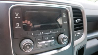

Which radio is this? '13 Tradesman

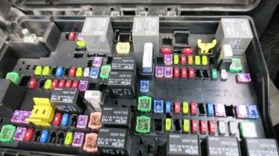

radio won't come on looking for correct fuse or other cause.

on my 2011 on the fuse box lid I think it is theres a diagram like you show and it says what each fuse goes to.

Found blown fuse by the brake booster.
Blew replacement.

Your radio is an RA1 3.0 Nontouchscreen, no Bluetooth radio , it's really easy to remove .
Two #25 tq screws up top.in the business card holder under the litle rubber mat . Once those two are removed pull straight out with both hands in the card holder only about an inch then gently work the bezel free ( it's just plastic snap plugs ) once you have the bezel off disconnect the electrical connectors and lay the bezel assy to the side . Now 4ea 7 or 8 mm head screws on the 4 corners of the radio . Next pull the radio straight out . Disconnect the mustard colored plug (XM) , white plug AM/FM ,grey MINI USB to the media hub in your console now the main disconnect ( depress lock and pull the handle out and to the left , your done . Sounds dificult to explain but this takes less than three minutes !
It's likely something wrong internally with your radio ...

Yup! It's the radio.
It looks previous owner/driver spilled something and it trickled into the radio from that little tray above and finally shorted something.
Could sure smell the burnt electronics inside.

It was the radio. It appeared something spilled on the dash and then dripped into the radio.
Got a replacement, (thanks R.L.K) punched in the antitheft code and it works fine.
