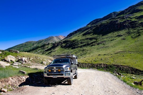

Really appreciate the reply! I had already put an AEV Dualsport lift on it and they are extremely hard and costly to reverse. I also just didn’t need it for a daily driver.
I ended up getting a 2020 Rebel with 1,492 payload and 11.5k tow capacity. It’s got the 3.92’s and the ride is so superior to my truck in comfort and noise.
I’m also a tech guy and like upgrading to new packages and mine has the 12A package I think, at least has the black leather interior with the big iPad touch screen and all. I’m happy with it so far and I think it was the right move honestly for all the reasons above plus less maintenance and diesel is quite a bit more pricey currently.
With that said, I’ve heard tons of great things about both the Carloi’s and Thurens. If I upgrade again that’s likely what I’d do. My old rigs below!A71BEA3F-3173-4F12-9D46-976222859BFC.jpeg
