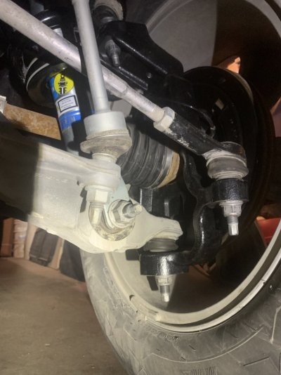

Just completed the spindle drop on my ‘23 4X4 using the 2wd drop spindles
As suggested by suppliers and other forum members everything fit and went back together fairly smoothly- minor trimming on the bottom of the dust shields to clearance the rotors/callipers and slightly tight brake hoses at full lock
Only real issue is the ride height- I’m sitting at 1.25max instead of 2”- truck is about 3.00-3.5” inches in the back- so it’s almost dead level- was hoping for a tiny bit of rake
Question is to members who have done this drop- did it settle a bit after it was driven?
Truck has 17000KM-10500 miles on it- I’m guessing the factory strut springs have already settled out?
Truck alignment looks real close (maybe 0 camber), so I have a bit of breathing room to make some changes before committing to having it aligned

Odds are it won't drop to much more if you already have 17000 clics on it.
They're rated at 2" on a 2wd,on the 4X4's it's closer to about 1.25 /1.5".
The 2wd spindles are actually a differant height then the 4X4 spindles,so you get more drop on the 2wd's then you do on the 4X4's.

Thanks for the info Rick, I figured you’d know something about it
I was toying with the idea of pulling it back into the garage and putting the Belltech 4wd drop coils (which I have) onto the 5100’s set at .75 to get a drop around 2.5”…..
I doubt I’ll touch it- it handles and rides really well- very pleased with that part of the drop- a little firmer than stock with the 5100’s

If you compare where the wheel hub hole and lower balljoint mounting point are on the 2wd and 4X4 spindles there's a differance between the 2 points.The 2wd spindles are also taller/longer
You’re right its definitely noticeable
Also the tie-rod mount on the drop spindles is quite a bit lower- almost a bind at full droop- couldn’t get the rack to move unless I jacked the control arm up 1”or 2
The stock track width of this truck before the drop stuck out a little more than my last 4wd- after the drop spindles the track width didn’t change much- definitely happy and surprised by that

Quick update
Just had the truck aligned by the dealership yesterday
As per Wild one- it needed almost no adjustment, tiny correction on the toe in
Had driven it for about 400km-250miles before the alignment just to make sure it didn’t need anything further from me- pretty happy with it so far- ride should even better when we get some better above 0 temperatures with the truck and road seams thawing out
