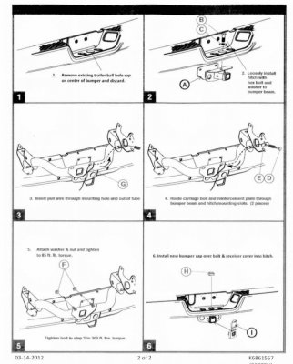

Per the installation instructions the bolt(1.125" nut) through the bumper needs to be torqued to 300 ft/lbs after the two in the back(0.75" nuts) are torqued to 85 ft/lbs
https://dev.smartdealer.com/mopar_accessories_isheet/K6861557.PDF
A lot of auto-parts stores will rent/loan out tools as most people don't have torque wrenches that are capable of 300 ft/lbsmoparhitch.jpg
