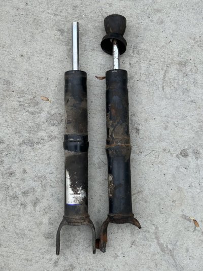

Your warlock has the 1” lift, all warlocks do. Your rear springs are about an inch taller and the front struts are preloaded for the extra 1”, this picture shows the warlock/outdoorsman/orp strut on the left and a standard strut on the right.IMG_8367.jpeg

Your warlock has the 1” lift, all warlocks do. Your rear springs are about an inch taller and the front struts are preloaded for the extra 1”, this picture shows the warlock/outdoorsman/orp strut on the left and a standard strut on the right.View attachment 551661
