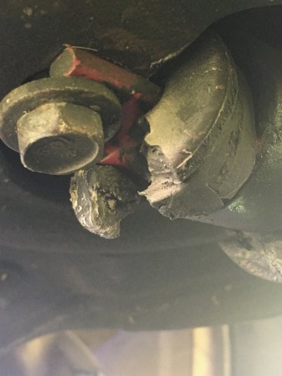

Went out and got some pictures today:
This is the bottom of the shock absorbers where they are connected to the bottom of the truck:
The driver side looks okay
The passenger side looks terrible, could be the big source of the problems
The passenger sway bar link is ripped on the bottom, and I hear the squeak of the sway bar badly over there, so I may replace the links soon and see how that goes

Most likely the ball joint on the side is what is making the noise but start with the end links and get new shocks if your able to do that yourself and what ever you can't do you can have your mechanic do.process of elimination
