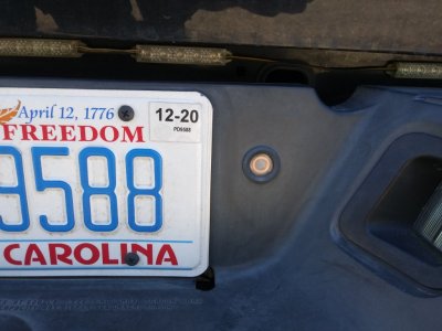

Does anyone here have a backup camera mounted in their bumper like I do? It hasn't worked since I bought the truck. I used the AlfaOBD & app and I get the "Camera not available" screen when I switch to reverse. I am guessing that the previous owner damaged it or broke it.
Can anyone give me any tips on possibly fixing this or a respectable place to buy a replacement without ripping my wallet to shreds?

Soooo, they removed the camera lenses from the tailgate handle and put it in the bumper?? Hmm. I would think the optimum spot for that camera would be were they put it, in the tailgate but uh, is there like an empty socket in your tailgate handle where it used to be? Did they replace it with a regular handle? I would drop your tailgate and unplug that big harness at the bottom of it to see how they connected it after the relocated it.

Regular handle in the tailgate.
Its a lense...my backup sensors are on my bumper like everbody else's.

What year is that pickup? I can’t imagine Ram sticking with the exact same camera lens throughout the years because uh, ya know, that would make too much sense but this is what the camera lens looks like on my 18.
OP, does your tailgate have the factory electric lock? If not, that would make it pretty easy to tell if your truck came with a camera or not because I would imagine that if it didn’t, you wouldn’t have that big plugin that I’m talking about on the bottom of your tailgate which would mean they tried to add a camera to it but if you do have that big plug, i would just probably drop the spare so you can look at the wire loom that goes to that tailgate plug to see if they just simply replaced the wires to run it to where it is now which means if they did, they probably did a ****** job reconnecting the wires. Hopefully they didn’t use butt-splice connectors. I could see that causing an ohm problem.

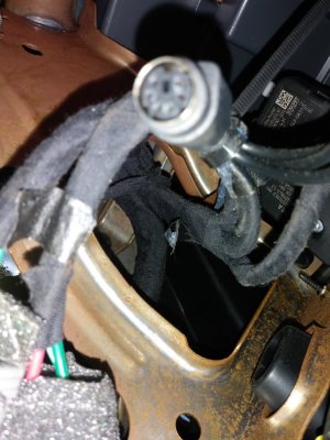

Pull the radio and see if sockets #31 ,32 ,33 are populated . If not the camera is not wired to the radio [emoji106]

Yes I have the electric tailgate lock. My truck is a 2015. I will try to get to the current camera set up tomorrow or Sunday. I'll be sure to take pics and keep you all in the loop! I gotta check again but I think I got the yellow RCA plug up behind my dash.

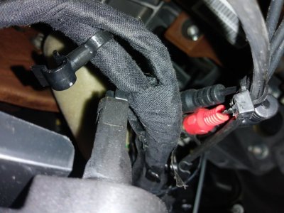

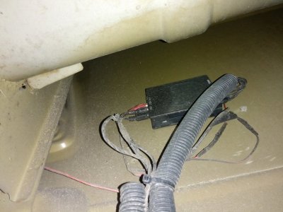

Here's what I'm lookin at...
I'm thinkin about removing the current setup and replace it with a new one.

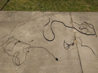

I got the oem 8.4...
I went ahead and yanked out the old crap after I chased wires and found cooked wires at the fire wall.
