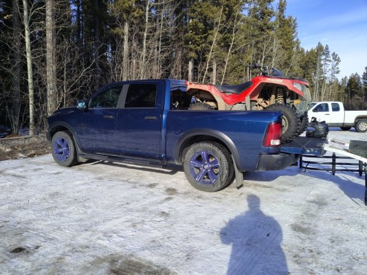

The TufTruck 1211's were not as stiff as I was hoping. I added a set of Sumo Springs (blue) to replace the bump stops just to level the rear when my trailer is hooked up.
My travel trailer is only 19' but I am not sure what the tongue weight is. Looking at the truck when I drop it on the ball it must be 2000lbs. :D
