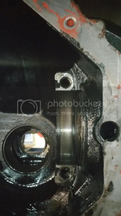

So a little while ago I posted about a noise I was having coming from the rear of my truck. I had a couple shops take a look at it and they both determined that the problem was with the ring and pinion.
Well after the one shop wanted a gazillion dollars to fix it and after talking with Marty up at SuperShafts (not one of the shops that actually looked at the truck) I decided he was the right guy to do the work. So I dropped the truck off with him Tuesday morning.
Today he texted me and sent me some pictures. Boy am I glad I went with him.
My whole rear is toast. I'm not 100% sure exactly what the problem is (I don't know rears well enough to really comment about it thats all) but I will say I was told the clutches are done, the ring and pinion are done and as you can see in these pictures one of the parts was cutting through the metal inside. The groove you see is not supposed to be there from my understanding.
Anyways Marty said he was going to look for a Dana 60 rear because it was the best option. He found one with an empty housing so that's what we are going with (with the 15"brakes).

Not sure about the brake problem. But I have seen a lot of axles like that. That has been messed up for a long time. The clips that hold the clutches for the limited slip break an slide out and rub on the bearing cap. If it has been caught sooner, you could have gotten away with bearings and a clutch replacement. Glad you are getting it sorted out now.

You are wrong. The recalls are for the pinion nut coming loose. His problem is completely different. Check out the pics.
Yea, the guy who's fixing it said he's seen 60 plus Chrysler 9.25's do this before. None as bad as mine though.
