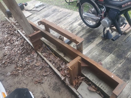

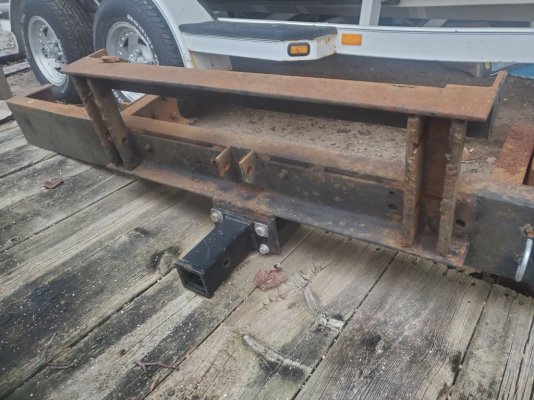

on my old superdookie i had a rear plow, kinda cobbled together but man was it nice to have it
the one i had before replaced the rear bumper with, well, a chunk of I beam, heavy and effective but ugly as sin
(of course, that truck was a ford, so it matched)
i talked to a local fabricator over the weekend to see if he would be comfortable welding the pivot points to my fabricated bumper, but he wasnt
he said SOP id to build a plate that installs like a draw bar into the trailer receiver
personally, that sounds a but flimsy, what are you guys thoughts on this?

This is kind of what I have in mind, it attached to the receiver and has 2 drag links for stability

For sure, but it seems flimsy to me, compared to how it *** originally mounted
This big ole anchor bolted right to the frame of the Ford, and it was solid
So coming from this, I was wondering how well a receiver mount actually works

Let's put it this way: if you have a Class IV (2") receiver, it's rated to pull something like 10k, WITH weight on it. If you have a Class V (2.5") they're rated to something like 15-18k. You're literally just dragging a piece of steel and some snow, with no downforce on the receiver. Even in thick, heavy snow, you won't be pulling anywhere near that amount of force. It will work just fine for many years.

You'll be stuck,long before you pull a Class V hitch mount plow off
thats not the part im worried about, what worries me is the 2.5 inch pintle just not being stable, i want it to be a mounting point, not a swivel point
but i admit, im most likely overthinking it
