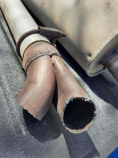

definitely send that factory y to the recycle bin, its not even worth the steel its stamped out of, a shameful smash and clamp job from ol ma mopar :33:
lucky for us we got things for that
:superhack:
