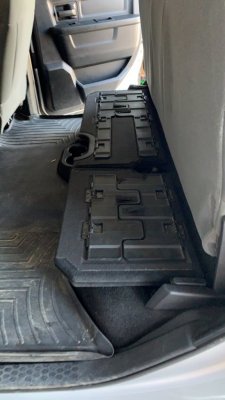

I just bought a 2019 Ram 1500 Classic last Saturday, Express with Night package.
I was wondering if there is a split rear seat that I could swap out in the future as it be very useful for me.
Also is there a kit or something I can get to make the rear floor flat covering the storage things under the seat too??
For the dogs mainly.

Unfortunately if you want to keep the same cloth pattern they do not make a split seat for the Express. It is available on the Bighorn and higher trucks but the seat cover is a different fabric so won't match your front seats. If the mismatch doesn't bother you any 4th gen rear seat should bolt right in. Many times when you buy the seat the fold flat floor will come with it. The fold flat floor is for the two piece rear seat but you should be able to install it on a one piece rear seat if you add the extra hardware. The extra bolt holes will be under your carpet. You can buy the fold flat floors used on ebay or wrecking yards. You can also build your own. There are write ups about it in the 4th gen DIY section.

I have made my own fold flat floor with plans I found on this website.. quad cab and club cab basically are the same with one piece being shorter for the QC.

I have heard a lot of good things about the DIY flat floor plans discussed in this forum. I had him email the plans to me and I will be taking this project on myself in the near future...for the dogs ;)

Scour fb and Craigslist. I just picked up a set of fold flat floors for $50. Installed them today. Spent another $2 on the bolts. My wife’s big horn has the split rear bench. It is nice and if I ever find one I’d snag it too
