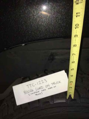

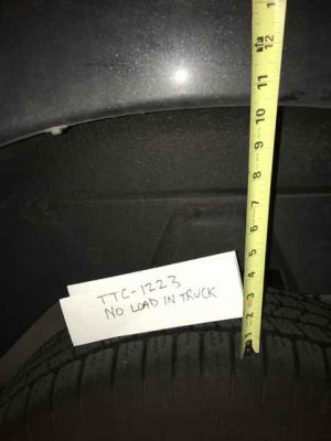

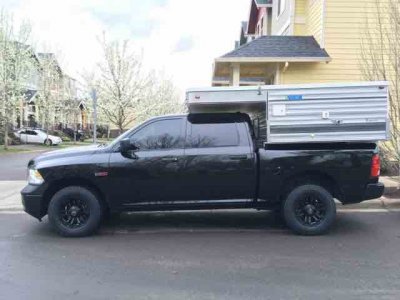

TufTruck TTC-1223 Rear Extra Heavy Duty Coil Springs
(Not the variable rate ones - these are intended for a constant load - like my camper that stays on)
Unloaded gives a 1.5 inch lift. Loaded with 800lb is exactly the same as stock.
