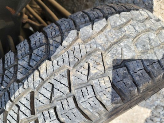

Pictures:
Front:
Rear:

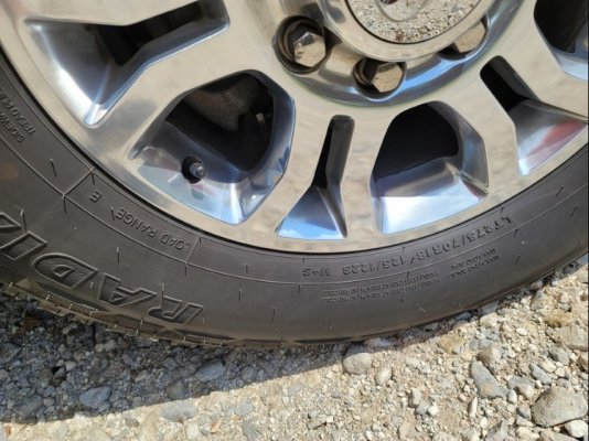

Tire spec/size:

Pictures:
Front:
Rear:
Tire spec/size:
my rears wear in the same spot, only worse, but then again I have under 30k miles on them.

I'd think is because the crazy high PSI you have to run in the 2500's, is it something like 80psi unloaded ? the rear tires are wearing down in the center a lot faster per those pictures. Lower the rear PSI and you'll have a better contact patch and less wear. (assuming you're not towing heavy you should be abe to lower your PSI)

The tires are Westlake SL369's. They get good reviews on Amazon, FWIW.
This^^^...... pressures to high. Your wearing the center tread away. Try lowering it by 5psi and keep track of the wear pattern. If there's no change, lower it another 5psi and keep track of the wear pattern until it's even all the way across.

Running them right at 80psi. I check them before every trip. Same pressure I've run for 30 years in my 3/4tons. I think the tread is just deeper on the outside, making it seem like they are crowning.
