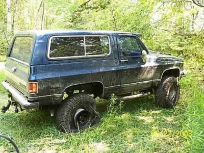

Jun 27, 2018
521
958
Naples, NY
3659D7DE-26E1-4EC6-80C3-4003356C9032.jpeg 0E5BB415-8817-4BE6-BB4A-D16055256F87.jpeg
Thanks will tried if it happens again, I was down to 50PSI today but the tread was filled with mud so I was running slicks going nowhere. I guessing about 30PSI would have been better.
I’ve been down to single digits in the mud at home...peeled a tire off the wheel! Only if I have bead-locks next time!
15psi is “safe” if not off camber or tearing it up!
(In an ‘88 K5)
