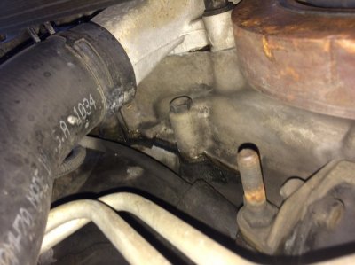

I checked the engine bay after the engine was warm, after about 5 min cool down. (Thanks for that tip!) I found a line of coolant along the junction between the timing chain cover and the engine block, passenger side. No other visible leaks.
Can air also get into the system from here, rather than pulling coolant in from the overflow tank?

Glad to hear you found it. I'd suggest a timing chain and tensioner while your in there.
And yes it will pull air in.
When it heat soaks after shut down the pressure bleeds out before it cools then when it dies cool it won't pull enough vacuum because you lost volume in the system and what vac it dies pull sucks the air in.
At the very least check the deflection and see if your close to going out of spec so you dont get a nasty surprise later on.
