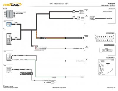

attached wire info no clue whats being said video did not show all of this

Brown/Red and Brown/Yellow MUST be hooked up. Those are your OBDII wires. Data wires are sensitive so make sure they soldered as well. It may not program without RAP hooked up either. Follow that diagram exactly and try programming again.

Yeah you definately need to hook up those two wires as stated above. Im suprised that the t harness doesnt include one for obd2 port (bad design). RAP shutdown wire is not needed for the remote start, either is parking lights, they are optional.

I just dont understand were the wire plug into
is there a plug hidden in the side kick
thanks
adrianp89
Sep 3, 2015
3,176
1,276
Tampa Bay, FL
It's the OBDII port under the dash. Where you put your scan tools. Honestly though it sounds like you may be better off just spending $50-$100 to have a professional get it finished correctly and you won't have to stress about it.
