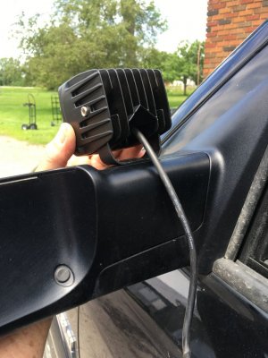

Anybody knows how to remove the black plastic cover on the towing mirror?
I was thinking on putting square leds on the arm, So would need to remove cover for fixation and wiring..
Thanks

I want to do the same thing. Not sure how it comes apart though. Hopefully someone knows.
I was also concerned about wind noise in that location, wonder how annoying it might be.

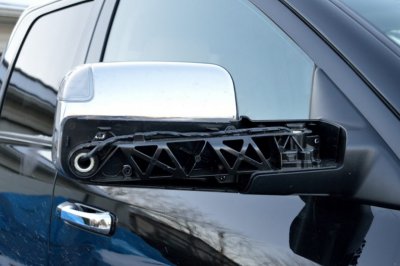

Start about in the middle and start pulling up/forward and work to the outside, a trim tool helps, there are just clips that hold it on, I had mine off last week, there is not much to attach a light to under that cover.
Thanks for the hint, i Will give it a try after work
The front part looks pretty sturdy to me, is it hollow inside? If there is place for the nut, it should hold the light no problem..

I found a photo of one removed from a google search, hopefully you can get an idea of whats under there
