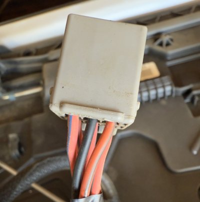

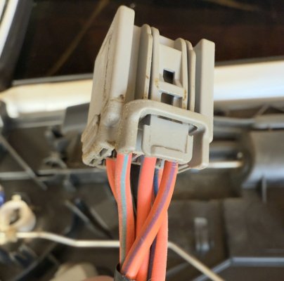

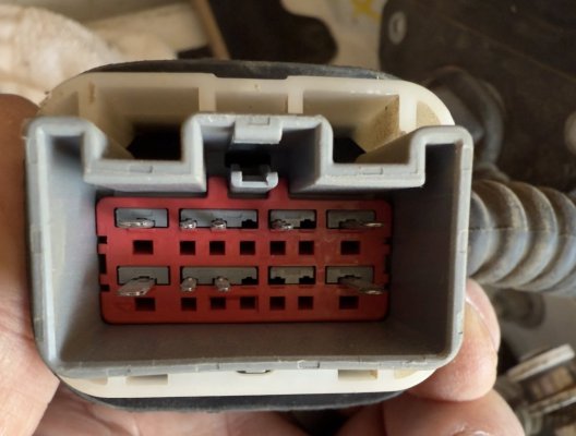

I’m in the process of replacing the rear passenger door. I got a complete door from the junk yard. Part of the disassembly of the inner door panel requires rolling the window down and releasing the window clips, pulling the window up and then you can remove the inner door panel. All fine on the current door. However the ‘new’ door isn’t powered (obviously) so I need to somehow power the window motor so I can roll it down. There are 3 points I can do that from; the wiring harness/plug where it attaches at the pillar, the window switch/wiring or the motor itself. So, I need the wiring diagrams for one of those. I’ve searched and searched and can’t seem to find a specific wiring diagram. Can simply apply 12v somewhere to make the window motor function? Attached are 4 photos.
1 - The connector for the door wiring harness where it attaches at the pillar.
2 - The inside of the window switch.
3 - Side view of the wiring at the window switch.

I need to know which pins or wires to connect power to.
OR, can I simply run power directly to the motor? Since there are only 2 wires attached to the motor, I assume power will move the motor one way, and reversing plus and minus will reverse the motor?

If you pulled the original door off of the vehicle
Lay the doors side by side switch the components
so that the new door uses the old door electric parts
just for information, any 2013 - 2018 Ram door would work, they are identical, except for manual or electric powered, all the bolt holes are there to mount the electrics.
Just make sure they are the same model trim, as in both doors would have to be the same size.
Rear doors , Crew Cab is different from Quad Cab

Solved. I did remove the window motor, but the window wouldn’t budge. There is a female spline/gear under the motor. I just found something that fit into it and turned it. The window was easy to lower/adjust after that.
Installed the new door and the original inner door panel and the original door panel. Had to swap the outside door handle. Other than that, everything fit perfectly.
