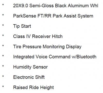

Mine has the raised ride height too :waytogo:
