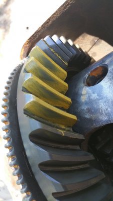

Hi. I spent most of the day changing the carrier bearings, ring gear, pinion, and pinion bearings in my 2004 Dodge Ram RWD, 5.7. The ring gear and pinion are Yukon, 3.9 ratio; the bearings are all Timken.
I got my preload set on the pinion according to the info that came with the Yukon kit. I also got the backlash done and then did my first gear pattern to see where things stand. I was wondering if I could get some feed back on my pattern so I know what to do next.
Thank you in advance!

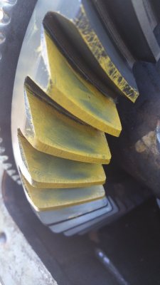

The larger shims that came with the kit are about the same size as the larger pinion bearing. Should they be placed between the gear and the bearing?
Tach_tech
Jun 1, 2014
3,320
3,595
5.7L HEMI
This a good chart to keep on hand. I’d say you need a thicker pinion shim.
The pinion shim goes between the bearing and pinion gear.

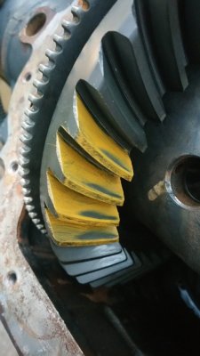

The more I thought about it, the more I realized my mistake. I pulled the bearing and put in shims to match the OEM thickness indicated by Yukon (.032"). I just got the pinion back on and my preload is perfectly within the parameters from Yukon (14-19 inch pounds... mine is around 17). Going to get something to drink and then put the carrier in, do the backlash, and then the gear pattern again. I will report back when I get a new pattern.
F
fosgate3
Apr 20, 2019
35
Monroe, LA
How does this look like for a pattern? It seems to look a lot like the first example in that chart. The backlash is set at 7.5 (5-9 was the range according to Yukon).

Looks a lot better. Try mixing a little gear oil with the marking compound, it will show the pattern better. I’ll usually use a wrench on one of the ring gear bolts and rock the carrier back and forth quickly as well to help show the pattern.
Should be good to go though.

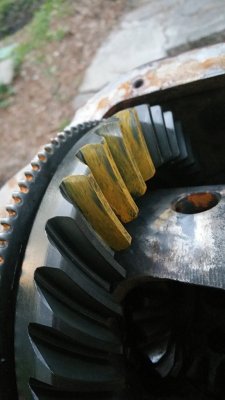

I added some oil to the marking compound...it's much more pronounced now. What say you?
Tach_tech
Jun 1, 2014
3,320
3,595
5.7L HEMI
As long as backlash, pinion rotation torque is in spec. Good to go, send it!
