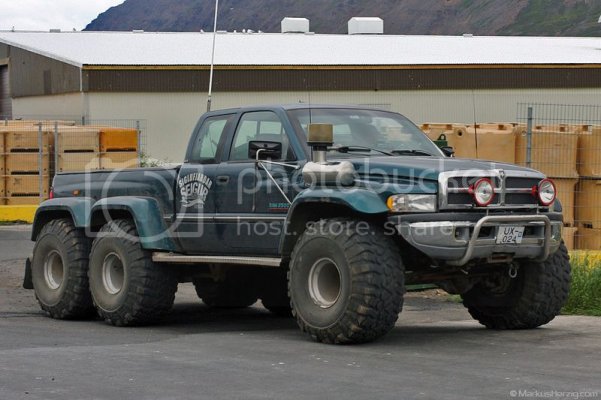

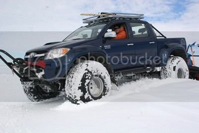

Look up Arctic trucks...read a little...pretty much no motor changes...they do regear but run stock axles...not all of them...but alot of them...and go with little or no lift...but stuff 38's and 44's regularly...

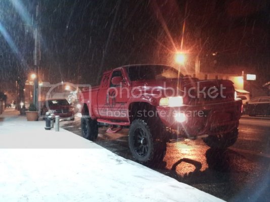

I'm running 5" suspension, 3" body and 37 x 13.5 nitto mud grapplers on big heavy 22" Rims....staying with 4.56 gears on these diffs as after much contemplation the 4.88s would be at a greater risk of breakage due to them thinning out in order to fit in these smaller diffs.
