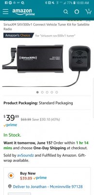

Need to know your hu fir sure but probably

Yep, the SXM timer is integrated into the factory radio.
If you go aftermarket, you will need to add a compatible SXM tuner. FYI, you (or they) can get an adapter harness online to use the factory SXM antenna/connector.

yea i found out it is in the stock unit.. so i ordered the sxv 300 and the sat1 connector for the maetro setup... so i could use the stock antenna and not that ugly ****** one.. lol
the svx comes with 3 months of sat and app for free.. so you pretty much gt the device free.. works for me cause MLB is on xm for the summer..
